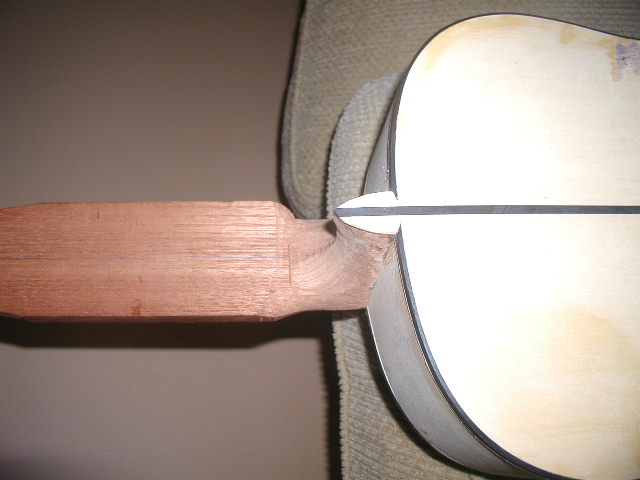

I'm working on a pair of flamenco guitars. The bodies are Alaskan Yellow Cedar, with ebony bindings. I'm trying to do binding details equivalent to the included picture cribbed from LMII. Luckily, one of the guitars is for me, and my knife technique is improving and hopefully will be cleaner for the second.
I probably have separate questions about the technique for doing this (I'm thinking about grinding a small homemade pairing chisel with a really low bevel angle), but right now I'm wondering how to keep the cedar clean while I do the detail sanding. I saw a discussion about maple bindings on ebony fretboards in the archives, and the suggestion there is that the maple would clean up once a high grit of sandpaper was reached. I don't know if the cedar will be as forgiving so I wanted to ask the question again. Will the original mess clean up at high grits? Should I put a few wash coats of shellac on before I do any sanding?

Yellow cedar and ebony both respond well to a sharp cabinet scraper, and you won't have dust problems.
For fine hand sanding, I've had some luck holding a 'blow-gun' connected to the air line in one hand and blowing the dust away as I sand.
Compressed air is really handy- I bought a $100 4.1 cfm compressor and though I can't run tools with it, it's been useful.
That's a pretty challenging binding detail in the picture from LMI. However, you can take heart in the fact that you will probably get your back inlay strip centered on the heel, unlike the example in the picture! This kind of stuff is all too 'high-risk' for me now- and my hat is off to anybody who tries it.

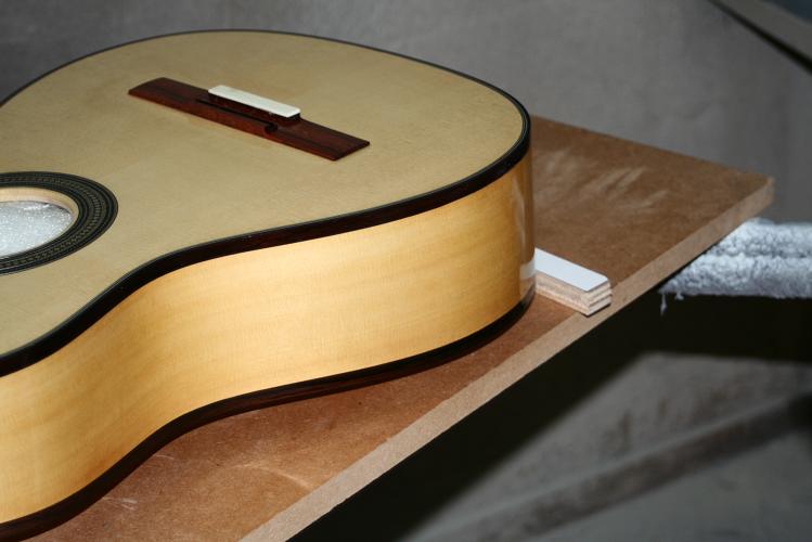

[QUOTE=JohnAbercrombie]
John - I wasn't going to say anything, but I was surprised that someone would pick that particular picture to showcase their work - I've been particularly careful to get my back strips centered on the heel.
I'll swallow my pride and exhibit the first of two attempts. I'm not real happy with how the bass side looks, but it's worse than the final will be here since nothing is sanded out yet.
Jim Kirby

[QUOTE=jtkirby]
Your work looks pretty good to me, Jim. I have a convenient 'rule' I use in such situations: "Anybody who would re-do this job is just obsessive about details, and needs therapy." It works for me!
You just have to take a look at some older instruments a few times to realize that the standards for 'neatness' have risen a lot.
